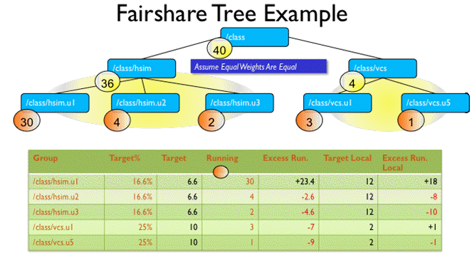

The Special Field FS_EXCESS_RUNNING_LOCAL
The picture below illustrates the difference between the FS_EXCESS_RUNNING field and FS_EXCESS_RUNNING_LOCAL. While the first considers the total number of running jobs in the system, the second field only considers the balance of running jobs at each local level. In the pictures, the nodes of interest are /class/hsim and /class/vcs.
The node /class/vcs has a total of 4 running jobs and 2 children, with user u1 running 3 jobs and user u5 running 1. Assuming that all weights are the same in all branches, the target share for /class/vcs.u1 and /class/vcs.u5 is exactly the same. Looking at the FS_EXCESS_RUNNING, it is negative for both nodes because the node /class/hsim has a large proportion of the running jobs. In this scenario, a preemption rule based on FS_EXCESS_RUNNING as shown below will not fire:

On the other hand, with a local view of /class/vcs, it is apparent that the distribution of jobs is not balanced. To use preemption to speedup the achievement of balance, the FS_EXCESS_RUNNING_LOCAL field can be used as follows:
VovPreemptRule -rulename RuleThatFires \
   -preempting   "JOBCLASS==vcs FS_EXCESS_RUNNING_LOCAL<0" \
   -preemptable  "JOBCLASS==vcs FS_EXCESS_RUNNING_LOCAL>0 FSRANK9>@FSRANK9@" \
    -pool fastfairshare  -ruletype FAST_FAIRSHARE
