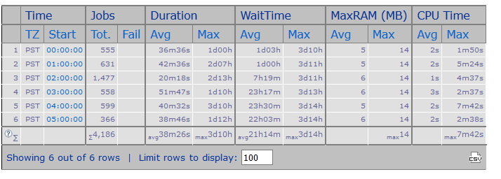

Statistics can be used to determine if additional resources are required, if resources could be better utilized by rescheduling jobs, and if resources are excessive.
Job reports can be viewed on a browser interface.
host:port/cgi/jobstats.cgi
generates a report on all the jobs
executed in a given time interval. This report includes the average and maximum
duration of the jobs, and the average and maximum waiting time.
