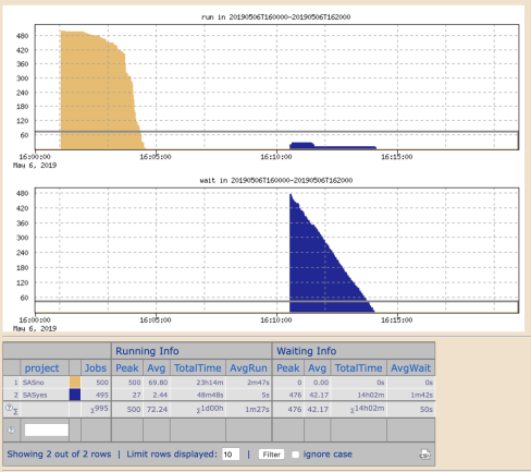

To quantify the difference between the two modes of operation, lets navigate the browser interface (Home > Workload > Job Plots) to look at this report (you will have to define a precise time range for the report, something of the form "20190506T150000-20190506T170000", then report by project with no binning)
In this report you see the two workloads. (In this plot the SASno experiment comes before the SASyes experiment). Look at the average run time of the jobs. In SASyes experiment, the average duration is 5 seconds, while in the SASno experiment the average duration is 2m47s, i.e. 33 times longer!
