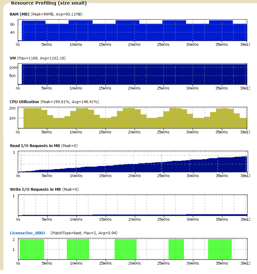

Job Profiling
When job profiling is activated, Accelerator tracks and plots performance statistics over the time the job is running.
The profiling plots show, in order, the following performance data over time:
  1. RAM usage
  2. VM size
  3. CPU utilization
  4. Cumulative Read I/O
  5. Cumulative Write I/O
  6. License checkouts (one plot per license)
The output of job profiling is a set of plots as shown below:
To activate profiling on a single job, use the option -profile of nc run as shown below:
% nc run -profile myJob
To view a profile, use the browser interface and visit the specific page for the job.
