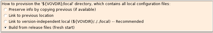

Carry Local Directory Forward During Install
The install process requires you to select how you want the program to provision the local directory during the installation.
The options include four different choices, which you select depending on how you manage your locally changed files and how you want them to be carried forward into a new release.
Figure 1. Install Dialog - Local Directory Section
You can have the install create a brand new set of files to start changing locally, or you can have the install do a copy of the files from the previous release's /local directory, or you can have the install make a symbolic link to the previous release's /local directory, or you can have the install make a symbolic link to the special /local directory that exist outside of a particular release, that holds the files.
During the first install you should select Build from release files (fresh start).
This tells the install to create a default layout having a platform-independent common/local directory holding initial files that can be changed locally. Each platform-specific /local directory will be a symbolic link to the platform-independent directory.

When installing a later release, you can tell the installer how to carry forward locally changed files into the new release so that the /local directories of the new release contain what was used in an earlier release.
There are three possible choices.
  1. The Recommended choice to Link to version independent local directory can only be done if you have set up a special release-independent /local directory as is described above. If you have created this setup, then the installation can create the release's /local directories as symbolic links to the release-independent /local directory.
    The other two choices direct the installer to create the new /local directories in other ways.
  2. Choosing the option to Preserve info by copying previous (if available) creates the release's common/local directory structure by copying it from the common/local directory in the previous release.
  3. Choosing the option to Link to previous location creates the release's /local directory structure by creating a symbolic link to the common/local directory in the previous release.
After the installation completes, following your directive on how to set up the common/local directory, you can do whatever you'd like to do with the /local directories. You can change the symbolic links to point to another directory. You can replace a directory's symbolic link with an actual directory having files that will be used in that particular context.
In order for the installation to perform the recommended option to Link to version independent local, the special release-independent /local directory must be set up exactly as described above. It must be in the top level install directory (/opt/rtda/local) and it must be named local.
