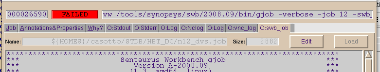

Customizing Altair Accelerator GUI
# Fragment of vnc.swd/gui.tcl
::VovGUI::addOutputTab "vnc_log" {/vnc_logs/[0-9]+/[0-9]+\.[0-9]+$} "+"
::VovGUI::addOutputTab "swb_job" {\.job$} "+"; ### ADD THIS LINE
