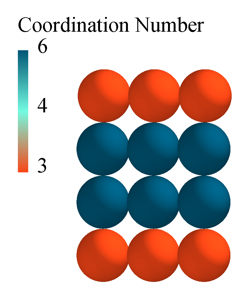

Coordination Number |
The coordination number of a particle is the number of contacts that a particle has with the spheres of another particle at any given point in time.
Below is an image of a 3-sphere particle shape. Four particles are placed on top of each other. The base and top particles have a coordination number of 3 as each particle is in contact with 3-spheres of the middle particles. The middle two particles have a coordination number of 6 as they are in contact with 3 spheres of the particle above and 3 spheres of the particle below.
The particle-geometry contacts are not counted in the coordination number.

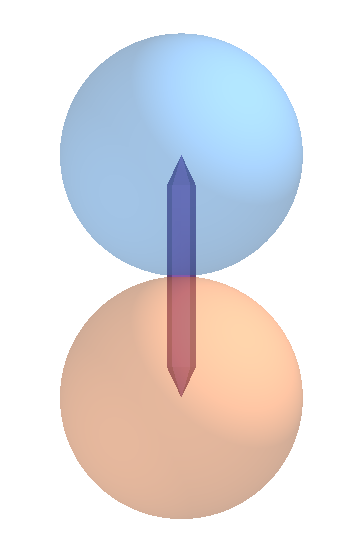

Contact vector 1,2 |
When two particles collide the contact vector is the vector connecting the contact point to the center of the particle.

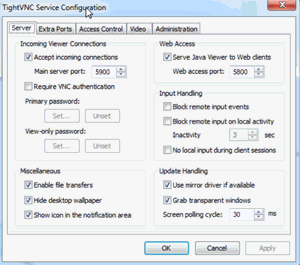

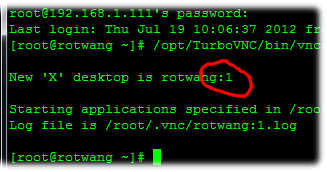

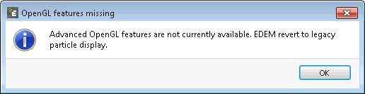

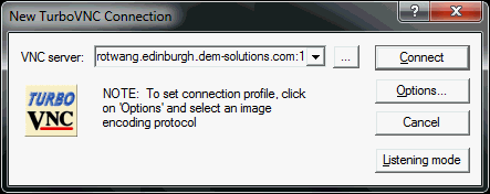

Typically, EDEM user’s setup simulations on Windows however often the simulation is run on a Windows or Linux processing machine which isn’t in the same location as the user.
A simulation can be setup on a local machine and copied to a Windows or Linux machine and run in Batch mode, this doesn’t require the user interface. See the help section Running EDEM in Batch Mode for further details.
However, if the user requirement is to use the EDEM Graphical User Interface (GUI) to access the Creator, Simulator or Analyst when working on a remote computer typically two different options are used. Windows Remote Desktop and VNC for Windows or Linux.

This option cannot be used by default when using Remote Desktop, the slower legacy display option has to be used, the section below provides details of a workaround for both VNC and Remote Desktop.
Remote desktop is installed on most Windows operating systems. To use please see the link below:
The advantage of using Remote Desktop with EDEM is that you can use all the local computers programs, files and network resources. One disadvantage of Remote Desktop is that it disables the graphics card on the processing machine and uses its own video driver to display the output. Described by Microsoft as:
“On the server, RDP uses its own video driver to render display output by constructing the rendering information into network packets by using RDP protocol and sending them over the network to the client. On the client, RDP receives rendering data and interprets the packets into corresponding Microsoft Windows graphics device interface (GDI) API calls”
This means that advanced features of EDEM designed to help speed up the display of large simulations (millions of particles) are also disabled and results in slow graphical performance when using Remote Desktop. You can check if the advanced graphical features are active in EDEM by going to Tools > Options > Particle Display.
If ‘legacy particle display’ is selected then EDEM is not using the processing machines graphics card effectively to display the particles, when using Remote Desktop the following message will be displayed if this option is not disabled:

VNC (Virtual Network Computing) is an alternative to Remote Desktop. This comes with a Client to be installed on the user machine and a Server to be installed on the processing machine, this can be a Windows or Linux processing machine. Typically, this requires administrator privileges to setup.
Typically, EDEM Engineers use Tight VNC for the server on the processing machine and Turbo VNC for user machine. The advantage of using Turbo VNC is that the advanced graphics card options can be used (de-select ‘legacy particle display' from EDEM Tools > Options > particle display).
Users should refer to the Turbo VCN and Tight VNC documentation for installation and use:
http://www.turbovnc.org/ - Turbo VNC website.
https://sourceforge.net/projects/turbovnc/files/ - Turbo VNC Download Page.
http://www.tightvnc.com/download.php - Tight VNC website and Download link.
It is recommended to reduce the Screen polling cycle for the Server to 30 ms (allows EDEM to display at 30 frames per second) for improved visualization speed, the default 1000 ms polling cycle resulted in slow EDEM display speeds.
On Linux VirtualGL and TurboVNC support remote OpenGL rendering which is required by EDEM. This requires VirtualGL to be installed, see the following link for more details:
To use...
/opt/TurboVNC/bin/vncserver
/opt/VirtualGL/bin/vglrun edem
/opt/TurboVNC/bin/vncserver -kill :1 <replace 1 with the number from step 2>
