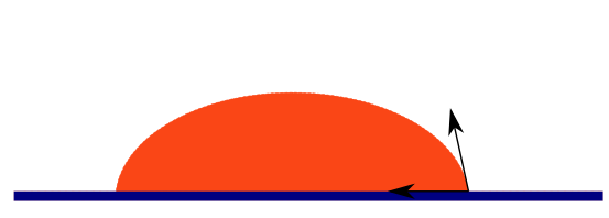

Wetting Angle: The angle where the surface meets the liquid:
