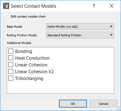

A contact model describes how elements behave when they come into contact with each other. Using the Interaction pulldown menu and + pick-list, you can build a list (stack) of contact models. The top element is applied first, then the next one down and so on. The models are automatically ordered, if an API model is added  use the up and down buttons to move the contact model up and down the list.
The contact models are split into Base Contact Models, Rolling Friction and Additional Models.
A base model defines the physical collision between particle materials or particles and geometries, typically the base model consists of spring forces and damping forces in the normal and tangential directions.  Only one base model can be added per simulation.
Rotational resistance and energy loss during rotation is also significant, most models include a Rolling Friction component to account for the materials resistance to rolling. Only one rolling friction model can be added per simulation.
Additional models such as bonding, heat conduction, wear, cohesion (if it is not included in the base model) and electrostatics can be included in addition to the Base and Rolling Friction models.
To add a model choose Edit Contact Chain and select the Base Model from the drop-down list, then select the Rolling Friction Model and finally use the tick boxes to select and Additional Models. To remove an item use the Edit Contact Chain to de-select Additional Models. If no Rolling Friction or Base model is required (for example if an API model is been used), choose the No Base Model or No Rolling Friction model.
