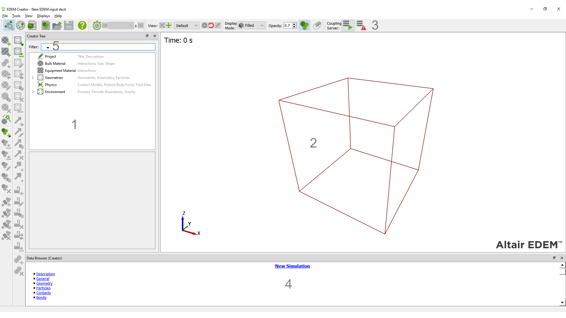

  1. The Creator Tree
The Creator Tree is displayed on the left side of the EDEM window. This allows you to input Bulk Materials, Equipment Materials and set the simulation Environment. The tree is driven by the icons and a ‘right click’ menu system. A similar Tree system is used in the EDEM Analyst.
  1. The Viewer
The Viewer displays 3D representations of your particles and geometry. The orientation, position and zoom factor of the Viewer are controlled using the mouse. The arrows in the bottom-left corner of the viewer indicate the current orientation: red (x), green (y) and blue (z).
  1. The Icon System
The icons enable the simulation to be setup, some icons are active at the start of a simulation. Others are only active once the simulation is partially setup.
  1. The Data Browser
The Data Browser is an .html page that displays detailed information about the contents of the Viewer: For example, particle properties and interactions or the dimensions of a geometry section.
  1. The Tree Filter
Filter option allows you to filter items in the tree by typing part of the name of the item. Only items that match, or those that have child items that match, the filter will be shown within the tree. All others are hidden from view.

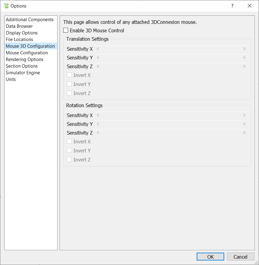

SpaceMouse Devices
EDEM now support the following SpaceBall or SpaceMouse devices from 3Dconnexion: SpaceMouse.
Before running EDEM, be sure that current drivers are installed for your device. EDEM will automatically detect and enable the use of the SpaceMouse once the device is connected and working properly.
The 6 degrees-of-freedom input on the SpaceMouse devices require no special configuration prior to using it within EDEM, however the Mouse 3D Configuration control panel may be used to adjust the sensitivity of the device, as well as how the axes respond to input.

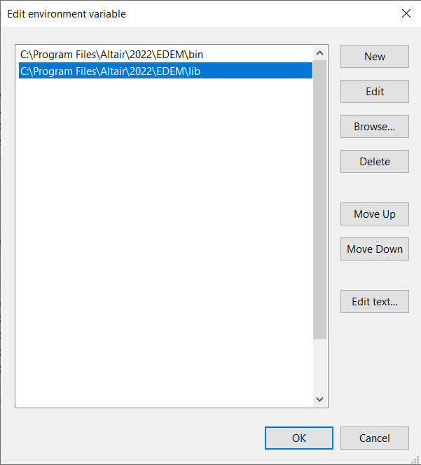

Windows: Adding EDEM to the file path
The path to the EDEM installation folder must be defined manually.  This is done using the environment variables.  If EDEM is installed to the default location the EDEM executable (edem.exe) is in the folder:
  1. C:\Program Files\Altair\2022.1\EDEM\bin

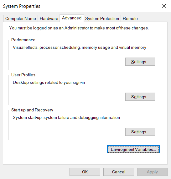

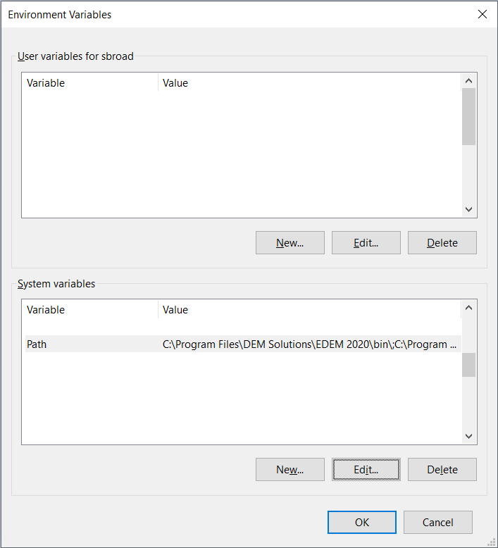

To add EDEM to the path:
  1. In the windows control panel navigate to the system option.
  2. Select the Advanced system Settings
  3. Select Environment Variables
  4. In the System Variables panel highlight the Path option then select “Edit”
  5. Select New
  6. Type the path to the EDEM install location (default: C:\Program Files\Altair\2022.1\EDEM\bin\)
  7. Repeat this for the location of the lib folder (default: C:\Program Files\Altair\2022\EDEM\lib)
  8. Click ok on each of the windows.
