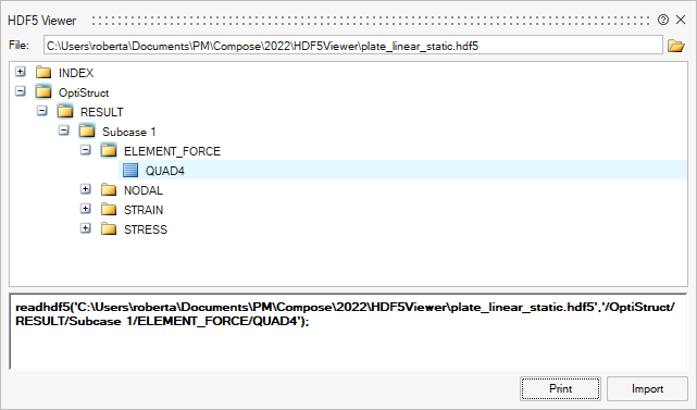

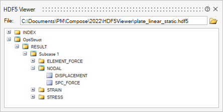

The data tree from the .hdf5 file is displayed. -

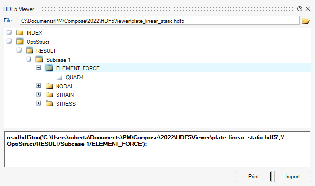

Select a group or dataset, then press the Print
button.
The Print option uses the readhdf5toc function to read in and display the data.

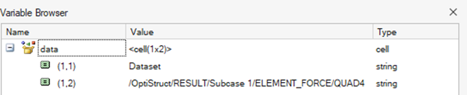

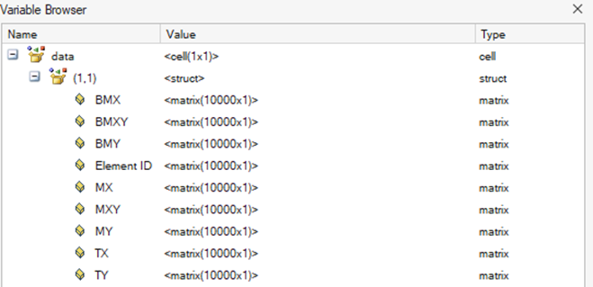

Select the Import button.
The Import option imports your selected group or dataset and displays the data in the Variable Browser.
- Group:
- Dataset:
