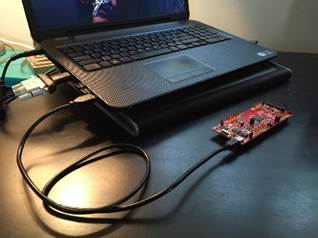

jtagInterfacePhotoA PIL application using a Texas Instruments F28069M LaunchPad microcontroller connected to Embed via USB is shown in the photo on the right.
