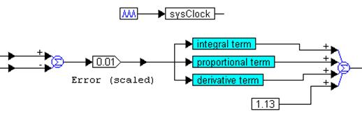

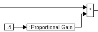

Inside PID Control (CONTROLLER), the output of the summingJunction is passed through a gain of 0.001 and fed as the error input for computing P (proportional), I (integral), and D (derivative) components of the controller. The proportional term, encapsulated in a compound block named proportional term is implemented as:
The proportional gain is set to 0.4.

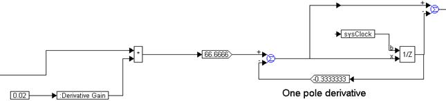

The derivative term, encapsulated as a compound block named derivative term is implemented as:
The computation of the derivative is implemented using a unitDelay block, two gain blocks, and two summingJunctions blocks, as shown above. The sysClock clock input to the unitDelay is defined using a pulseTrain block, and the contributions of the P, I, and D terms are summed up, as shown below.

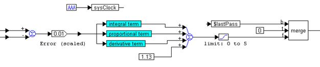

Because the motor needs a minimum of 1.13V to turn, a constant bias of 1.13V is added to the mix. To ensure that the voltage applied to the motor is within the rated voltage range, and to shut the motor down when the simulation run is complete, the limit and merge blocks are used, as shown below.
The output of the merge block is forced to zero after the last step of the simulation, represented by the system variable $lastPass. For all other steps, the limit block restricts the output to the range 0V to 5V, as shown above.
