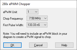

Description: The ePWM Chopper block lets you configure the chopper unit for the ePWM.
Interactive mode: The entire block is inactive in this mode.
Additional information: Texas Instruments SPRU791A document.
Chop Frequency: Specifies the base frequency of the chopper.
ePWM Unit: Specifies the ePWM module to be configured.
First Pulse Width: Indicates an integer value from one to 16 to set the width of the first pulse. You specify this parameter to provide a high-energy first pulse to ensure hard and fast power switch turn on.
