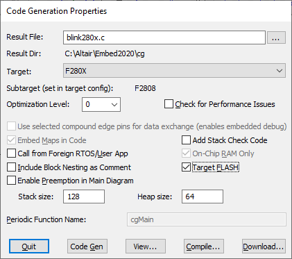

2. Click Tools > Code Gen.
3. Activate Target FLASH. You can leave the remaining parameters as they are.
4. Click Compile to create an OUT file that will run from FLASH. The OUT file is stored in the specified result directory.

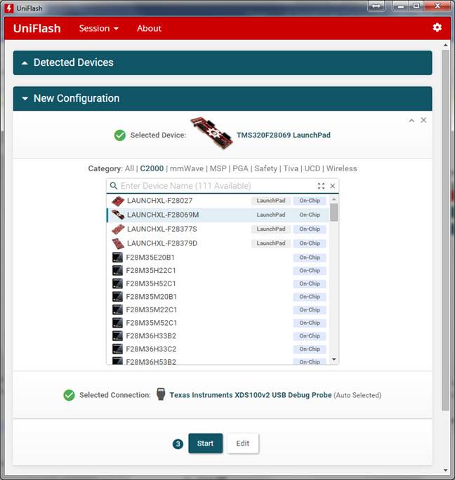

6. Start UniFlash.
7. Under New Configuration, select your target device and connection.
In the above window, the Texas Instruments F28069M LaunchPad is selected. The corresponding XDS 100v2 USB Debug Probe connection is automatically selected.

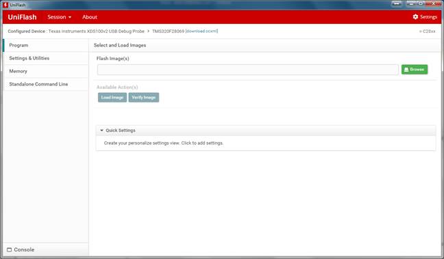

8. Click Start to select and download your OUT file to FLASH. The following dialog box appears:
9. Under Flash Image(s), click Browse and select the OUT file you created in Step 4.
10. Under Available Actions(s), click Load Image.
Note: To verify that the OUT file was written to FLASH, click Verify Image.
