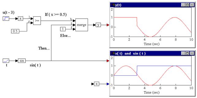

1. Simple if-then-else construct
Consider a variable y such that:
If x ≥ 0.5 then y = sin(t); else y = 1
where t is simulation time. Let x be a unit step delayed by 3s. This is usually represented as u(t - 3). This system can be realized as shown below.
Until the onset of the step input at t = 3s, the Boolean inequality x 0.5 evaluates to false and y takes on a value of 1. At t = 3s, the Boolean inequality evaluates to true and remains true for the duration of the simulation duration. Consequently, from this point onwards, y takes on the value of sin(t).
