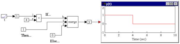

2.  Modified if-then-else construct
The previous example can also be realized as:
The key difference in implementation is the use of a merge block rather than a * block. The merge block explicitly depicts the if-then-else structure; the * block is a shortcut and can lead to confusion.
