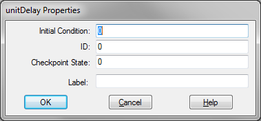

You can set the initial conditions for unitDelay blocks with variables. You can also reset unitDelay blocks to zeros using the System > Reset States command.
Checkpoint State: Contains the value of the unit delay at the checkpoint. If you have not checkpointed your simulation via the System > System Properties command, the value is zero.
ID: Reserved for future use.
Initial Condition: Sets an initial value for the output signal. The default is zero.
Label: Indicates a user-defined block label.

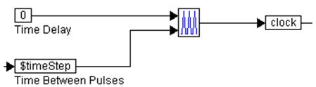

If you are working with unitDelay blocks, it is good programming practice to create a clock signal that you can use in every simulation. A typical clock signal can be generated as shown below.
Here, a pulseTrain block is assigned two external inputs:
      The top input is the time delay for the pulseTrain block. The time delay value for the pulseTrain block is the amount of time the pulseTrain block waits before producing pulses. This time delay value must not be confused with the amount of time delay generated by the unitDelay block.
      The bottom input is the time between pulses.
The output of the pulseTrain block is fed to the variable clock. This variable can be used anywhere in the simulation to clock unitDelay blocks.

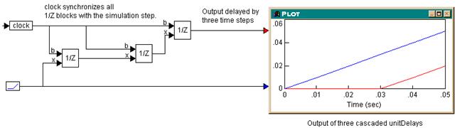

3. Using a multi-step delay with cascaded unitDelay blocks
To achieve multi-step delays, unitDelay blocks that implement one-step delays, can be cascaded. Consider the example where a three-step delay is introduced.
Three unitDelay blocks, all clocked at the simulation step, are cascaded. Since each unitDelay introduces a one-step delay between its input and output, the output of the third unitDelay block is delayed by three steps compared to the input. The plot block shows this behavior, with a simulation step size of 0.01.
