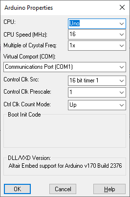

The Arduino Config lets you configure settings for the Arduino. After you enter the settings, an Arduino Config block is inserted into the diagram.
Boot Init Code: Specifies user C code to initialize the chip.
Control Clk Prescale: Chooses the prescale factor for the PWM based control clock. If the PWM is also used as an output peripheral, this setting must match the setting of the PWM block in the diagram.
Control Clk Src: Chooses periodic sampling interrupt source for the main control loop in Embed.
CPU: For some targets, there is a family of CPU types. It is important to select the exact CPU type for the specified target.
CPU Speed: Indicates the speed of the CPU.
Ctrl Clk Count Mode: Chooses the count mode for the PW-based control clock. If the PWM is also used as an output peripheral, this setting must match the setting of the PWM block in the diagram.
Multiple of Crystal Freq: Indicates the multiple of crystal frequency.
Virtual Comport: Chooses the serial communications port that corresponds to your Arduino. If you do not know the correct serial port number, start the Arduino IDE and click Tools > Port to find it.
