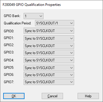

The GPIO Qualification block lets you choose the qualification time interval for GPIO pins on the Delfino, F280X, and Piccolo. Selection of qualification can help filter noise and remove glitching from external signals.
GPIO Bank: Selects the bank of 8 GPIO pins to configure.
GPIO0-7: Selects synchronization or qualification duration for a given GPIO pin.
Qualification Period: Selects the duration of a Qualification sample.
