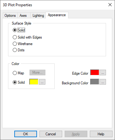

If you select a surface plot, you use the Appearance property sheet to control the surface style and color, the background color of the plot, and the edge color.
Background Color: Specifies the background color of the plotting window. To choose a new color, click … and make the appropriate selections in the Color dialog box. Click OK when you are satisfied with your selection. The color you chose is previewed next to Background Color.
Map: Applies a spectrum of color. To choose the saturation and lamination of the colors, click More and make the appropriate selections in the Mapping Color Setup dialog box. Click OK when you are satisfied with your selection.
Solid: Applies a solid color. To choose a new color, click … and make the appropriate selections in the Color dialog box. Click OK when you are satisfied with your selection. The color you selected appears in the box to the left of the … button.

Edge Color: If you selected a Surface with Edges plot style, you specify the color of the edges (that is, the mesh superimposed over the plot) with Edge Color. When you click … to the right of the Edge Color box, the Color dialog box appears that allows you to choose a color, its hue, saturation, and lamination, as well as create a custom color. When you are satisfied with the color, click OK to return to the Appearance tab. The color you selected is displayed next to Edge Color.
