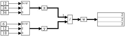

3. Division of vectors
Consider the equation:
w = x/y
where x = [12 24 36] and y = [6 12 18] realized as:
When the simulation runs, the / block performs an element-by-element division operation on the incoming vectors. For example, w(1) = x(1)/y(1), w(2) = x(2)/y(2), and so on.
