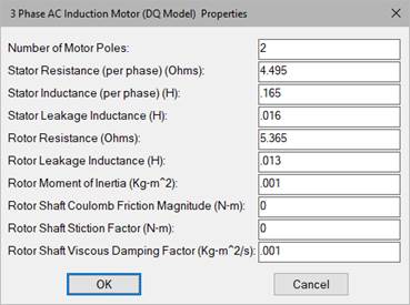

Number of Motor Poles: Indicates the number of motor pole pairs.
Rotor Leakage Inductance: Indicates the specified rotor leakage inductance in henries.
Rotor Moment of Inertia: Indicates the moment of inertia of the rotor with respect to the axis of rotation in kg-m2.
Rotor Resistance: Indicates the rotor winding resistance in ohms.
Rotor Shaft Coulomb Friction Magnitude: Allows specification of constant directional dissipative force (Coulomb model) in units of N-m.
Rotor Shaft Stiction Factor: Allows specification of a stiction force value or break-away torque. This parameter is normally not specified by the motor manufacturer, but can be obtained experimentally. Units are in N-m.
Rotor Shaft Viscous Damping Factor: Indicates the factor that linearly relates viscous damping force to angular velocity. This parameter is normally not specified by the motor manufacturer, but can be determined experimentally. Units are kg-m2/s.
Stator Inductance (per phase): Indicates the stator per phase coil inductance in henries.
Stator Leakage Inductance: Indicates the specified stator leakage inductance in henries.
Stator Resistance (per phase): Indicates the stator per phase coil resistance in ohms.

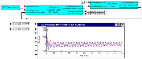

Diagram name: ACIM DQ Model
Location: Examples > eMotors (Legacy) > AC Induction
A DQ frame voltage source is created using a three-phase source, and Clarke and Park’s transforms (see example under Park Transform). Rotor displacement is connected to the Rotational Load block. Reaction torques are fed back to the motor model. DQ transient currents are observed by plotting signals from the output wires provided on the motor model.
