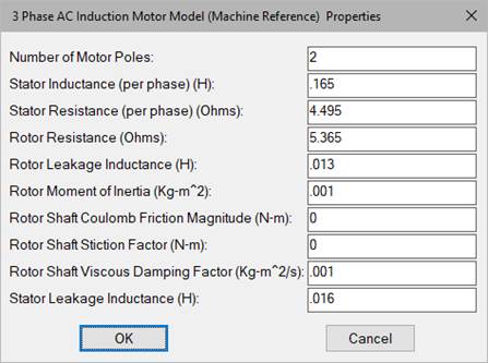

Number of Motor Poles: Indicates the number of motor pole pairs.
Rotor Leakage Inductance: Indicates the specified rotor leakage inductance in henries.
Rotor Moment of Inertia: Indicates the moment of inertia of the rotor with respect to the axis of rotation in kg-m2.
Rotor Resistance: Indicates the rotor winding resistance in ohms.
Rotor Shaft Coulomb Friction Magnitude: Allows specification of constant directional dissipative force (Coulomb model) in units of N-m.
coulomb_friction_1
Rotor Shaft Stiction Factor: Allows specification of a stiction force value or break-away torque. This parameter is normally not specified by the motor manufacturer, but can be obtained experimentally. Units are N-m.
stiction_model_1
Rotor Shaft Viscous Damping Factor: Indicates the factor that linearly relates viscous damping force to angular velocity. This parameter is normally not specified by the motor manufacturer, but can be determined experimentally. Units are kg-m2/s.
Stator Inductance (per phase): Indicates the stator per phase inductance in henries.
Stator Leakage Inductance: Indicates the specified stator leakage inductance in henries.
Stator Resistance (per phase): Indicates the stator per phase resistance in ohms.

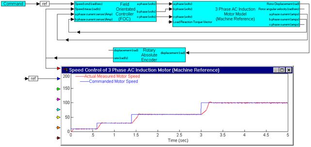

Example
Diagram name: ACIM Mach Ref
Location: Examples  > eMotors (Legacy) > AC Induction
The following simulation example illustrates the application of the Field Orientated Controller-sim block in controlling speed of a three-phase AC induction motor using a rotary encoder for feedback. Current is sensed using the motor model output currents. The command profile shows stable and accurate control of speed over a wide range of speeds.
acim_mach_ref_exmpl
