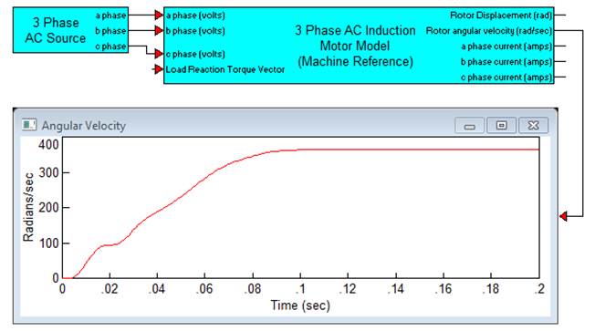

Diagram name: 3P AC Source
Location: Examples  > eMotors (Legacy) > AC Induction
Driven by a 155 VRMS, 60 Hz three-phase source (220V peak amplitude), the three-phase AC induction motor rotor angular velocity without load connected is driven to 371 rad/sec steady state. Field rate is 2*π*60= 377 rad/sec. The slip is calculated by:
