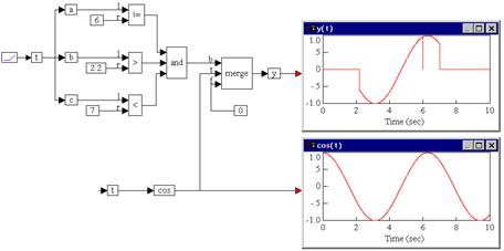

1. Three variable and
Consider a variable y such that:
If a ≠ 6 and b > 2.2 and c < 7, then y = cos(t); else y = 0
where t is simulation time. Furthermore, let t be the input to all three parameters a, b, and c. This system is realized as:
The output of the and block is true only when all the three inputs are true. This happens in the range t = (2.2, 7), except for the instant t = 6. This result is apparent from the top plot block. The variable y is equal to cos(t) in the range t = (2.2, 7). At the instant t = 6, variable a is momentarily false, and consequently, y = 0 at t = 6, since the output of the and block evaluates to false at that instant.
