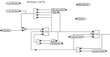

Consider the bouncing ball animation shown below:
The ball is represented as a single animate block. Movement is introduced by changing the ball’s x,y screen position coordinates. As the simulation progresses, the signals entering the animate block continually update its position. The diagram below drives the simulation of the bouncing ball.
To create the illusion of depth, you can vary the ball’s w,h size coordinates.
The values fed into the x, y, w, and h inputs represent display pixels. The x, y position 0,0 is the upper left corner of the Embed window. Positive values extend to the right and down. For your image to appear on most video screens, keep its position within the bounds of a VGA screen (640x480).
You must perform all coordinate conversion manually. For example, the equations that determine the position of a bouncing ball are shown below:
However, before the output of the resetIntegrator block can be fed into the animate block, the position of the ball must be mapped to screen coordinates, as shown below:
The objective is to animate the bouncing of the ball as a function of time. This means that time is the independent variable, or the x-axis. A ramp block is used to generate time, which ranges between 0 and 1000. A gain of 0.5 is used to scale time so that the amount of space used on the screen in the horizontal direction is limited in the range 0 to 500 pixels.
