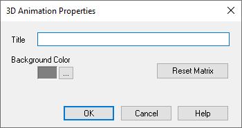

Background Color: Specifies the background color of the plotting window. Click … to change the color of the window. You can choose a color, its hue, saturation, and illumination, as well as create a custom color. When you are satisfied with the color, click OK. The color you selected is previewed in the dialog box.
Reset Matrix: Undoes the position and rotation applied to the 3D object and resets the object to correspond to its initial transformation matrix. When resetting the transformation matrix, Embed brings the 3D axes (and eventually the 3D object) back to their initial positions.
Title: Specifies a title for the 3D plot. Titles can be up to 80 alphanumeric characters. The title appears in the 3D plot title bar. By default, 3D plots are titled 3D Animation.
