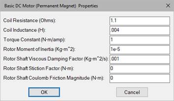

Coil Resistance: Indicates the line-to-line coil resistance in ohms.
Coil Inductance: Indicates the line-to-line coil inductance in henries.
Torque Constant: Indicates the specified motor torque constant in N-m/Amp.
Rotor Moment of Inertia: Indicates the moment of inertia of the rotor with respect to the axis of rotation in kg-m2.
Rotor Shaft Coulomb Friction Magnitude: Allows specification of constant directional dissipative force (Coulomb model) in units of N-m.
coulomb_friction_1
Rotor Shaft Stiction Factor: Allows specification of a stiction force value or break-away torque. This parameter is normally not specified by the motor manufacturer, but can be obtained experimentally. Units are N-m.
stiction_model_1
Rotor Shaft Viscous Damping Factor: Indicates the factor that linearly relates viscous damping force to angular velocity. This parameter is normally not specified by the motor manufacturer, but can be determined experimentally. Units are in kg-m2/s.

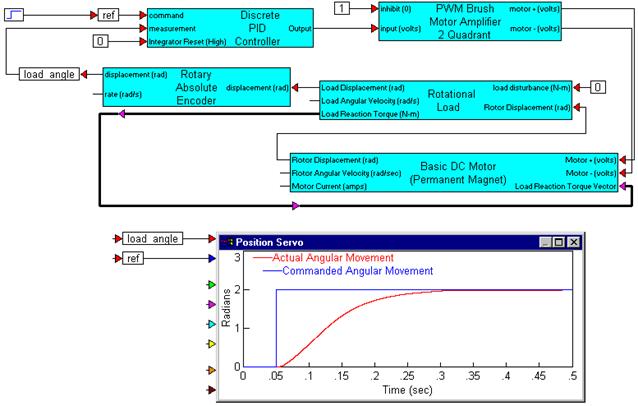

Example
Diagram name: Basic DC Motor
Location: Examples  > eMotors (Legacy) > Brush DC
The following simulation example demonstrates a voltage-controlled servo loop for positioning a geared load (0.5 ratio) to multiply torque. The load is spring loaded by setting a torsional spring constant in the Rotational Load block. A Rotary Absolute Encoder block is coupled to the load and the measurement is fed back to a PID compensator for voltage control of the motor. A power amplifier of unity voltage gain with sufficient power gain to drive the motor is assumed. The motor is commanded to move 2 rad in the positive direction.
basic_dc_motor_exmpl
