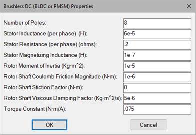

Number of Poles: Indicates the number of rotor poles.
Rotor Moment of Inertia: Indicates the rotor moment of inertia along the axis of rotation in kg-m2.
Stator Resistance (per phase): Indicates the per phase winding resistance of the stator in ohms.
Rotor Shaft Coulomb Friction magnitude: Indicates the constant dissipative force imposed by the rotor bearings/bushings in N.
Rotor Shaft Stiction factor: Indicates the static friction (break-away) force imposed by the rotor bearings/bushings in N.
Rotor Shaft Viscous Damping Factor: Indicates the viscous damping factor imposed by the rotor bearings/bushings in kg-m2/sec.
Stator Inductance (per phase): Indicates the per phase inductance of the stator winding in henries.
Stator Magnetizing Inductance: Indicates the difference between the stator per phase inductance and the stator leakage inductance in henries.
Torque Constant: Indicates the average torque constant of the motor in Newton meters/amp.

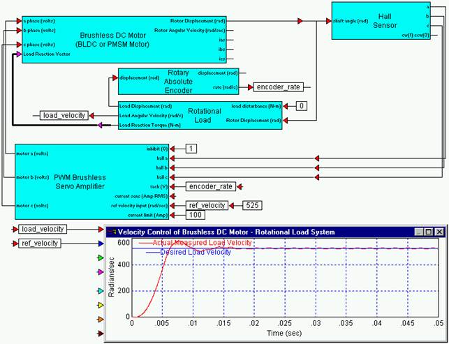

Diagram name: Brushless PWM Servo AMP
Location: Examples > eMotors (Legacy) > BLDC
The following example illustrates speed control of a DC brushless motor using a PWM Brushless Servo block in feedback with a rotary tachometer generator. Note that Hall sensors used to commutate the motor are connected through the PWM amplifier.
