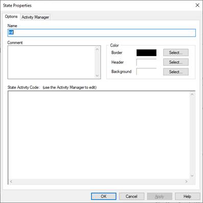

1. Right-click in the title bar of State1.
2. In the State Properties dialog box under Options, do the following:
•Under Name, enter Init.
•Under Color, select a color for the border and a color for the header.

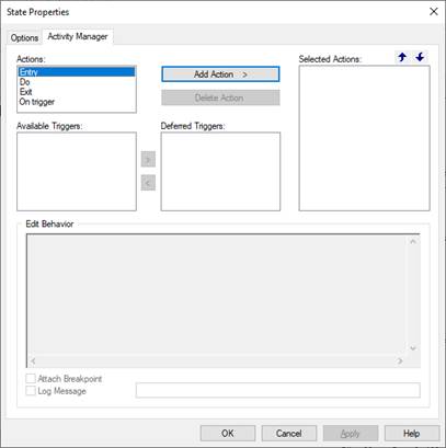

3. Click the Activity Manager tab to select an action and enter behaviors.
4. Under Actions, select Entry and click Add Action.

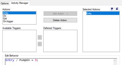

5. Under Edit Behavior, enter the C code to indicate the pump is OFF, as shown below.

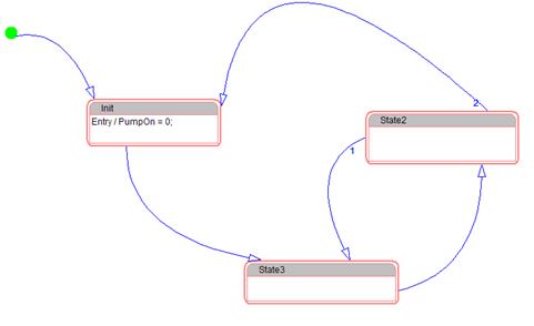

Your state chart will look like this:

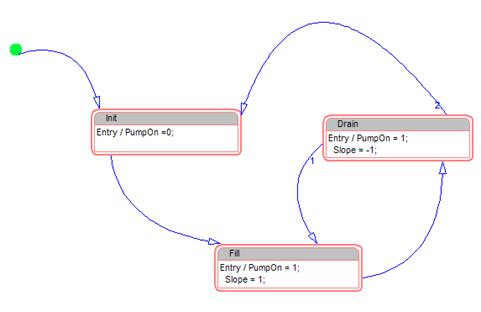

7. Repeat steps 1 – 6 for State2 and State3 so that your state chart looks like this:
