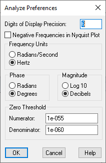

To correct the polynomials
1. Choose Analyze > Preferences.
2. In the Digits Of Display Precision box, enter a number that indicates the round-off for poles and zeros.
3. Under Zero Threshold, enter the appropriate values in the Numerator and Denominator boxes. Based on your knowledge of the system, you may raise or lower the threshold for zero treatment. The defaults are 1e-011 (for the numerator) and 1e-060 (for the denominator). Polynomial coefficients whose absolute values are less than these values multiplied by the absolute value of the largest coefficient in the polynomial will be set to zero.
4. Click OK, or press ENTER.
