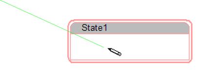

1.    Position the cursor over the edge of a source state. The cursor shape changes to a pencil (Pencil).
Note: If the crosshair has arrow heads, moving the mouse moves the state rather than draws the arc.
2.    Depress the mouse and drag into the target state body.
statechart intro example state1 wire
3.    Release the mouse button.
The transition will appear as a straight line from the source state to the target state.

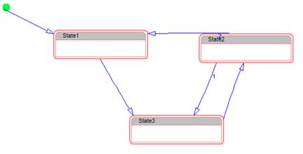

4.    Repeat this exercise to create the following:
Creating a simple state chart initialstate and  3 state blks transitions
 Notice that when multiple transitions are coming from a given state, Embed labels them according to evaluation order.  Transitions with lower numbers have higher priorities.

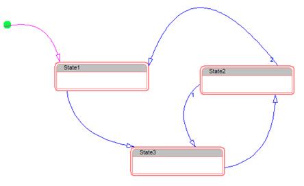

4.    Repeat step 1 for each transition arc until you have the following:
