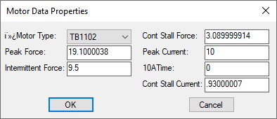

Description: When you attach a data table to a dialogTable block, Embed arranges and presents the information from the data lists in the dialogTable dialog box. For example, the dialog box below lists parametric data for a TB1102 motor:
Click the DOWN ARROW in the Motor Type box to select a different type of motor. When you do so, Embed updates the dialog box with data corresponding to the newly selected motor.

The Properties dialog box appears, like the one shown below:
The field names in the header record are the parameter names in the dialog box. The information from the first data record is displayed in the text boxes.
2. To display another data record, click the DOWN ARROW for the first parameter — in this case, Motor Type — and select the item whose data record you want displayed. Embed updates the information in the remaining text boxes accordingly.
