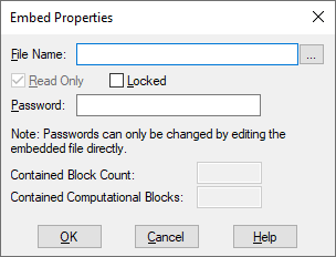

3. Right-click the embed block, or choose Edit > Block Properties and click the block.
The Embed Properties dialog box appears.
4. In the File Name box, do one of the following:
•Enter the name of the diagram file to be embedded. If you do not see the file you want, click … to search for it.
•Enter a path alias in this format: $(path-alias). You define path aliases with Edit > Preferences command.
The dialog box also lists the total number of blocks contained in the embedded diagram, along with the number of computational blocks.
5. Click OK, or press ENTER.
