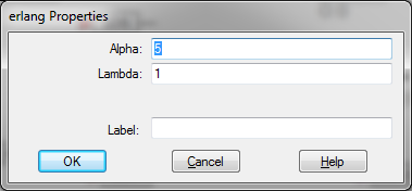

Alpha: Specifies the shape of the curve. You must specify an integer greater than 0. The variance is proportional to alpha. You can enter a value in hexadecimal notation or as a C expression
Lambda: Is referred to as the rate parameter. As you increase the value of Lambda, the variance decreases by lambda2. You can enter a value in hexadecimal notation or  as a C expression
