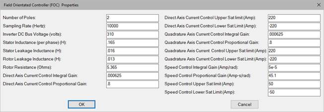

Inverter DC Bus Voltage (volts): Sets the voltage level of the PWM pulses for each phase voltage.
Number of Poles: Indicates the number of motor pole pairs.
PI Direct Axis Current Controller
PI direct axis current control receives a direct axis current command from a field model and direct axis current measurement. The error between these quantities is then fed to an anti-windup PI compensator.
Direct Axis Current Control Integral Gain: Typically sets the speed (bandwidth) and tracking error of the control loop. Units are 1/sec.
Direct Axis Current Control Proportional Gain: Typically sets the damping of the control loop.
Direct Axis Current Control Upper Sat Limit: Sets the upper output limit of the PI direct axis current controller. Hard limiting is designed to prevent compensator integral wind-up. Units are in amps.
Direct Axis Current Control Lower Sat Limit: Sets the lower output limit of the PI direct axis current controller. Hard limiting is designed to prevent compensator integral wind-up. Units are in amps.
PI Quadrature Axis Current Controller
PI quadrature axis current control receives a quadrature axis current command from the speed controller and quadrature axis current measurement. The error between these quantities is then fed to an anti-windup PI compensator.
Quadrature Axis Current Control Integral Gain: Typically sets the speed (bandwidth) and tracking error of the control loop. Units are 1/sec.
Quadrature Axis Current Control Proportional Gain: Typically sets the damping of the control loop.
Quadrature Axis Current Control Upper Sat Limit: Sets the upper output limit of the PI quadrature axis current controller. Hard limiting is designed to prevent compensator integral wind-up. Units are in amps.
Quadrature Axis Current Control Lower Sat Limit: Sets the lower output limit of the PI quadrature axis current controller. Hard limiting is designed to prevent compensator integral wind-up. Units are in amps.
PI Speed Controller
PI speed control receives a target speed command, and actual speed measurement. The error between these quantities is then fed to an anti-windup PI compensator.
Speed Control Integral Gain: Typically sets the speed (bandwidth) and tracking error of the speed control loop. Units are amp/rad.
Speed Control Proportional Gain: Typically sets the damping of the speed.
Speed Control Upper Sat Limit: Sets the upper output limit of the PI speed controller. Hard limiting is designed to prevent compensator integral wind-up. Units are in amps.
Speed Control Lower Sat Limit: Sets the lower output limit of the PI speed controller. Rotor Leakage Inductance: Indicates the specified three-phase AC induction motor rotor leakage inductance in henries.
Rotor Resistance (Ohms): Indicates the three-phase AC induction motor rotor winding resistance in ohms.
Sampling Rate (Hertz): Sets the clock rate for all the operations in the FOC. This rate must be set sufficiently large to provide modulation depth for the SVPWM. A value of 10,000 Hz or greater are typically set. Note that the simulation step size must at least meet this frequency.
Stator Inductance (per phase): Indicates the three-phase AC induction motor stator per phase inductance in henries.
Stator Leakage Inductance: Indicates the three-phase AC induction motor specified stator leakage inductance in henries.

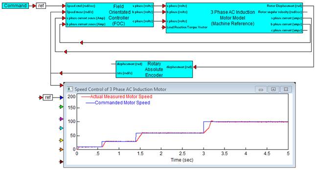

Example
Diagram name: FOC Controller
Location: Examples  > eMotors (Legacy) > AC Induction
The following simulation example illustrates the application of the Field Orientated Controller-sim block in controlling speed of a three-phase AC induction motor using a rotary encoder for feedback. Current is sensed using the motor model output currents. The command profile shows stable and accurate control of speed over a wide range of speeds.
