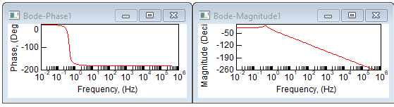

The Frequency Response command lets you set the phase and gain margins before displaying the Bode phase and magnitude plots, like the ones shown below:
Both plots are relative to log frequency (in rad/s units). The magnitude units are log and the phase units are degrees.
