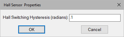

Hall Switching Hysteresis (radians): Sets the Hall device switching hysteresis characteristics. Units are in radians.

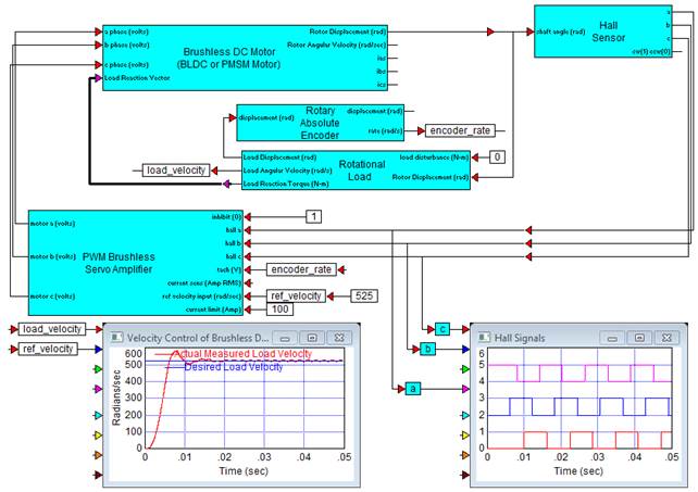

The simulation below shows a speed control loop for a DC brushless motor using the Hall sensor triad for electronic commutation.
