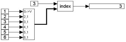

1. 6 x 1 vector
A 6 × 1 vector fed into the index block yields six possible execution paths, as shown below.
The index block outputs 1, 2, 3, 4, 5, or 6 depending on whether the index value is 1, 2, 3, 4, 5, or 6, respectively. In this example, the index value is 3, causing a 3 to be output.
