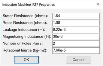

Description: The Induction Motor-IRTF block is a motor model for a three phase AC Induction machine. This is a mathematical model of an electrical machine based on Ideal Rotating Transformer model. A four parameter model representation, as shown below, is used.
Leakage Inductance (H): Indicates the combined (stator/rotor) stator referred leakage inductance in henry.
Magnetizing Inductance (H): Indicates the stator
referred magnetizing inductance in henry.
Number of Pole Pairs: Indicates the number of motor pole pairs.
Rotational Inertia: Indicates the inertia of the rotor (plus mechanical load if attached).
Rotor Resistance (ohms): Indicates the stator
referred rotor resistance in ohms.
Stator Resistance (ohms): Indicates the stator
winding resistance in ohms.
Slip (shown in the equivalent model above): Defined as where
represent the synchronous and
mechanical shaft speed, respectively.
