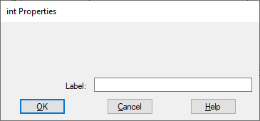

Block Category: Nonlinear
Input: Scalar
Description: The int block outputs only the integer portion of the input. The int block does not perform numerical round-off operations. Thus, an input of 2.9999 yields 2. Inputs can be scalar constants or scalar variables.
