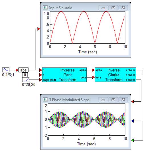

The following diagram uses Park’s and Clarke’s inverse transforms to create a three-phase modulated signal at a specified rotation frequency (20 rad/sec). The input signal defines the envelope of the modulated signal and the angle rate defines the three-phase frequency.
