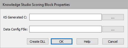

Description: The Knowledge Studio Scoring block uses the specified C file and accompanying Data Config file to generate a DLL that can simulate the response of the decision tree before deploying it on to a hardware for verification.
Data Config File: Indicates the complete path to data configuration file. This file can be a CVS or TXT file. Click … to browse your directories for the file.
KS Generated C: Indicates the complete path the C file generated by Knowledge Studio. Click … to browse your directories for the file.
