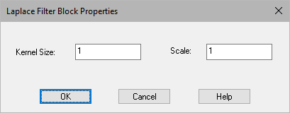

K Size: Specifies the aperture size used to compute the second derivative filter. The value must be odd and positive. The default value is 1.
Scale: Specifies the scale factor for the computed Laplacian values. The default value is 1.
In this example, the kernel size is 3 and the scale is 2.
