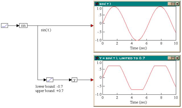

1. Simulation of saturation
Consider a variable y such that:
Furthermore, assume that y reaches saturation at +0.7 and -0.7. This equation can be realized as shown below.
From the results in the two plot blocks, the output of the limit block is identical to the input, when the input is within the bounds (-0.7 to +0.7). When the input is out of these bounds, the output is limited to the upper or lower bound values.
