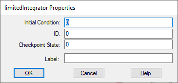

Checkpoint State: Contains the value of the integrator state at the checkpoint. If you have not checkpointed your simulation using the System > System Properties command, the value is 0. You can enter a value in hexadecimal notation or as a C expression.
ID: Represents an identification number for the block, which holds the state number that Embed assigns to the integrator. The number of states in any block diagram equals the number of integrators. The default is 0.
Initial Condition: Indicates the initial value of the integrator. The default is 0. You can enter a value in hexadecimal notation or as a C expression.

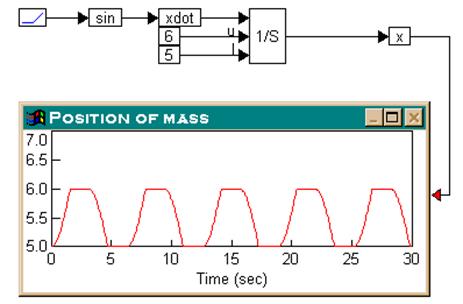

1. Integration with constant limits
Consider a system whose dynamics are given by the differential equation:
Furthermore, assume that x must lie in the limits 5 ≤ x ≤ 6 and that x(0) = 5. This system can be realized as shown below.
During simulation, the limitedIntegrator block limits the output to be within the upper and lower limits, namely 6 and 5, respectively.
