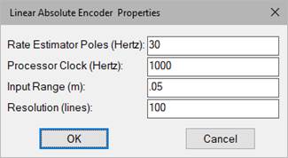

Input Range: Specifies the end-to-end stroke of the encoder in meters.
Processor Clock: Defines the processor clock rate for rate estimation.
Rate Estimator Poles: Defines the bandwidth of rate estimation. The selection typically requires a tradeoff between rate estimation accuracy and noise. Units are in hertz.
Resolution: Indicates the total number of lines over the stroke of the encoder.

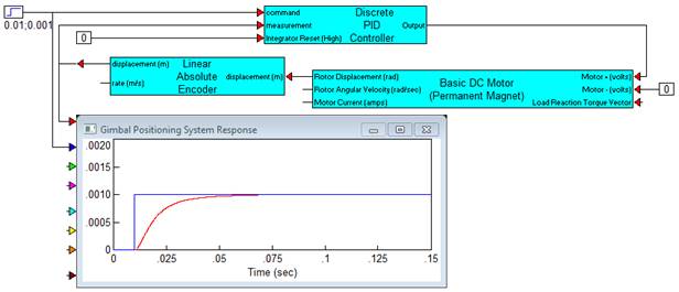

Example
Diagram name: Linear Encoder
Location: Examples  > eMotors (Legacy) > Sensors
A voice coil actuator is driven by a gimbaled mount for fine angular positioning of a steering mirror. Since the angular stroke is small, a small linear optical encoder is used at the gimbal periphery for estimated angular position and rate feedback measurements. The requirement calls for a step input response rise time of under 10ms with minimal overshoot and settling. Steady state accuracy must be within 2 arc sec. To test initial feasibility for the proposed control, the following simulation diagram is used with the Linear Encoder block to assess a rough design. The number of lines is varied to determine the effects on the dynamic response and steady state accuracy of the feedback loop.
