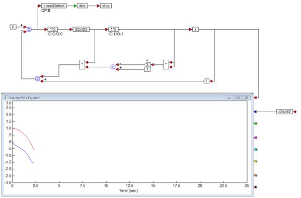

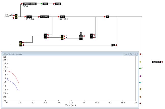

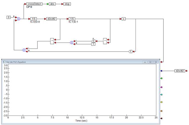

1. Wire a crossDetect block to the d2x/dt2 signal.
2. Feed the output into an abs block, which is wired to a stop block.
3. Wire the d2x/dt2 signal into the plot block.
In this configuration, the simulation is automatically stopped when the d2x/dt2 signal is exactly 0. The crossDetect block outputs 1 or -1 depending on whether the crossing occurs with a positive or negative slope. Since the stop block stops the simulation only when the input is 1 or greater, an abs block is introduced between them to ensure that the stop block receives only positive inputs.
4.
Choose System > Go, or click the
toolbar button.
The simulation runs to the first occurrence of signal d2x/dt2 = 0.

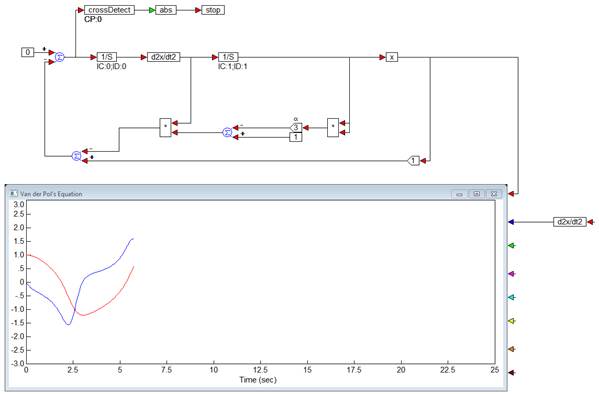

5.
Choose System > Continue, or click
toolbar button to continue the simulation
to the next occurrence of d2x/dt2 = 0.

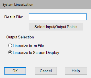

6. Choose Analyze > Linearize.
7. Do one of the following:
•To display the ABCD matrices in four separate, successive dialog boxes, select Linearize To Screen Display.
•To write the matrix information to an M file, select the Linearize To .M File and enter a file name in the Result File box. For this example, the contents of the file will be:
