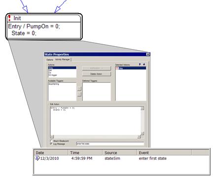

Example
In this example, the state Init has message logging enabled. When the simulation runs, the eventDisplay block logs the message.
